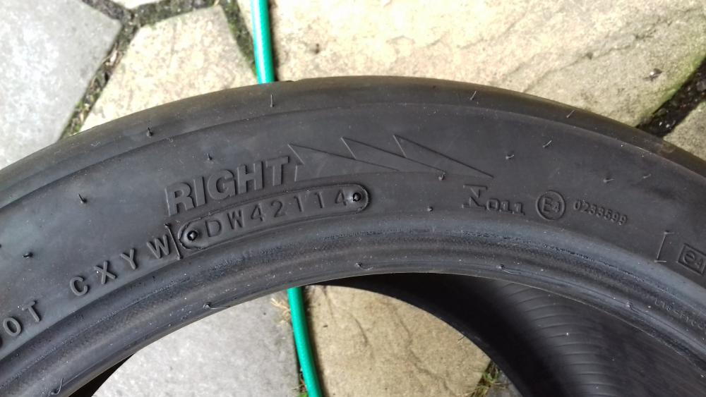

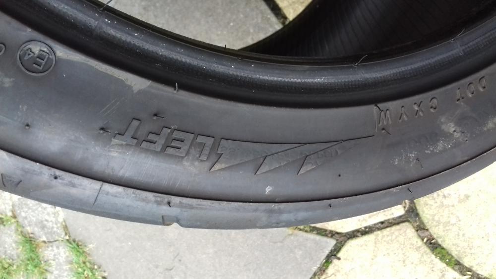

Are you positive about that statement? Are they marked with both an "OUTSIDE" marking and a directional marking? I don't remember that at all when I used them years ago. I would be very surprised if you are correct on this.Just adding to this, the markings on the tire are for how it mounts on the wheel, so in other words if the wheel is going on the left hand side of the car the fitter turns the tire accordingly.
So you could purchase another Toyo R888 tire and mount it to your wheel.

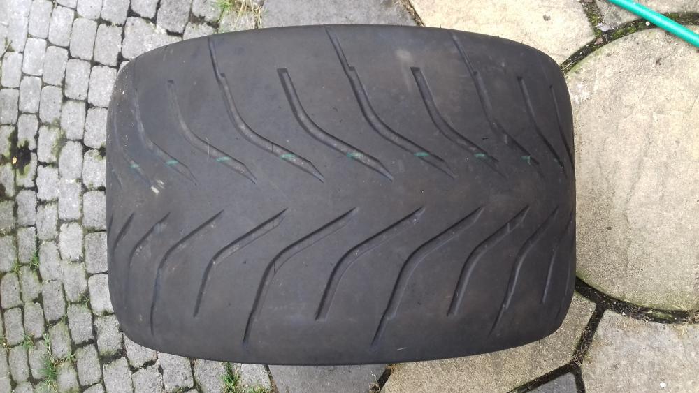

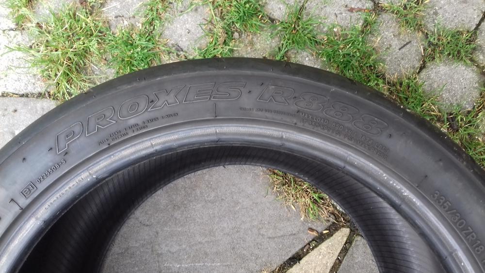

Hope that makes sense. 🙂Just took some photos of a spare Toyo R888 I have in the garage for you, so you can see what I mean
Remember, these markings are for how it mounts on the wheel, (not the car).20170715_110603.jpg
20170715_110647.jpgAs you can see on the tire, the left and right arrows are how you mount it to the wheel in what ever rotation the wheel is traveling.
The fitter flips the wheel to the tire, not the tire to the wheel 🙂 -
