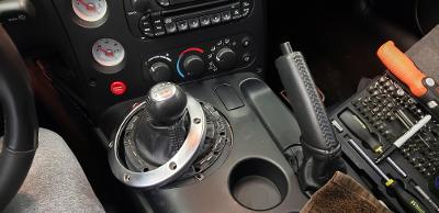

      1. Remove Ring
      2. Lift Leather Boot

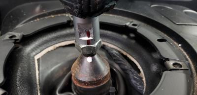

      3. Index(mark) shifter nut. Easier to re-install in correct alignment.

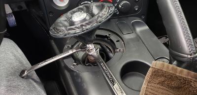

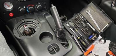

      4. Loosen shifter nut 16mm and 19mm
      5. Remove Shifter and Boot
