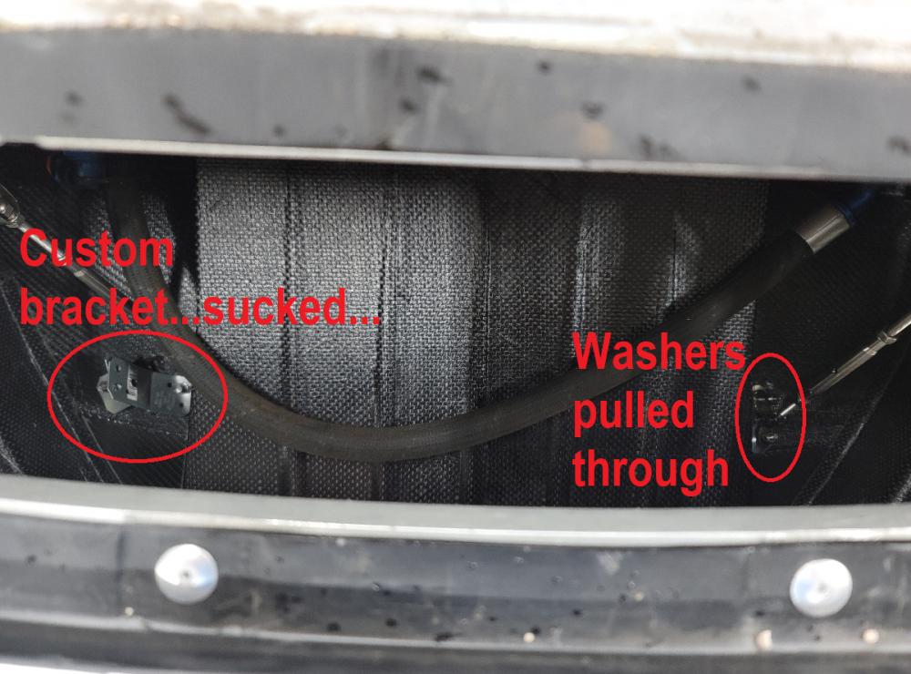

      Minor little problems are all part of the game. Good try on the splitter fix, 155mph probably trying to hold up 300-400lbs and some knarly harmonics going on. You didnt give up is all that matters some days
      Yep. Looking forward to giving it a go. Downside about something like this, most likely you won’t know if it’s good until you’re on track.
      I may sneak a spirited drive up the local highway in the early morning hours and see if I can feel any shudder.
    • TKO MOTORSPORTS TEAM
      Post count: 778
      if you want to send a pic or explain your fix glad to take a look.

      The first attempt was pretty weak. haha I’ll send you an email shortly with what my next attempt will look like.

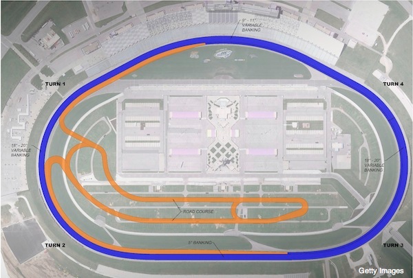

      This weekend I joined NASA Central at Kansas Speedway to run their ‘roval’ course (counter clockwise). The only variation from the below photo is they ran a make-shift bus stop on the back to slow people down. I’ve never quite seen a chicane as narrow or as short as this. It definitely served it’s purpose.

      Sunday in the first session I bested my lap time from Saturday by 6 seconds, and cracked into the top 5 of the event, but also ran into some bad luck when my interior cable supports for my splitter pulled the bolts through carbon fiber on the splitter and destroyed one of the two brackets. My wife and I made a run to the hardware store for bolts, washers and something I could fashion into a bracket. About an hour of ‘mending’ it back together, I was hesitant to give it another go, but really wanted to jump up in the timing so I went back out. Made it around on the out lap with no problems, but once getting up to 155mph or so on the straight, they both failed again and I was forced to limp around with the splitter buffering the whole way.
      Today, I ordered a new support (one of the two broke), and 4 6×6 inch titanium sheets that I’ll use to reinforce above and below the splitter to prevent this from happening again. Good news is, while I was out there, I really enjoyed the canards and the taller wing, it’s amazing how much of a difference more aero makes.
