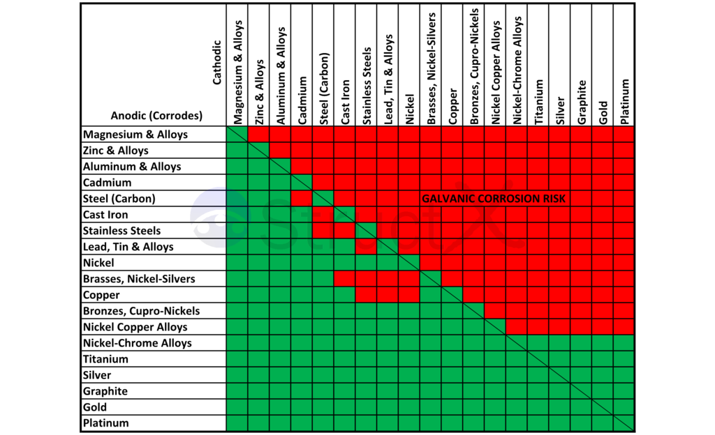

      The side sills are aluminum, so while they won’t rust, galvanic corrosion is definitely a concern that needs to be taken into account. If you are really concerned, just do a Google search for a galvanic corrosion chart and come up with something like this:

      I want to use m6x1x20 as thats what the original spec size is….i dont want to drill and tap the thing to a different size of bolt. I will track down a bolt based on the specs in that chart. Thanks for the info!

      Does anyone who has more than a chemistry minor, which I tripped and fell into because a physiology degree takes you one credit away from a chem minor, know more about the galvanic corrosion? That chart is helpful. But is there anything that acts as a catalyst for the reaction that would matter here? Such as living in a humid climate or near salt water air? I would think salt water air would provide a good medium for those electrons to jump across. Though, wouldn’t the corrosion be more likely to cause the nut and bolt to seize together than to corrode away completely? At least in the time frames we are dealing with here. In 5000 years I don’t think it matters much. Or would living in a dry climate slow that reaction to such a pace that it ceases to matter?
