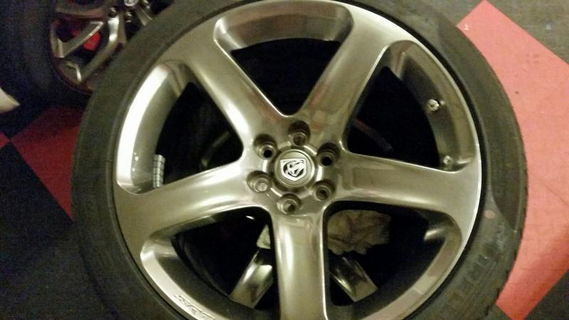

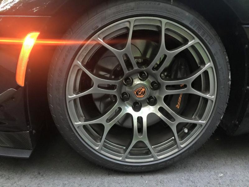

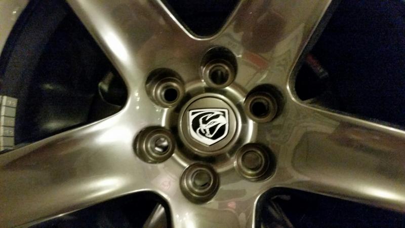

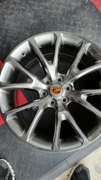

      FYI… The name of a matched paint is “Hyperblack” JXY-W is the paint code for touch up paint. No paint is a true match for this color.
      The only real way to get the hyper blackmatch for larger damage is to do the true process. It requires a special hyperblack coating on gloss black paint. I do this coating on my centercap modification to make them match the wheels.
