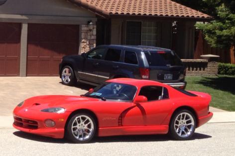

      Viper-New-Rims.jpgI have original 17s that I only use at track now and have 2004 Rims (18/19 stagger) on car and its only about 3-4 miles and hour different at 65 (from watching GPS vs doing math). It looks like 61 mph on dash is about 64-65 on GPS when running the 18/19’s. After getting adjusted to it gave up on looking for a calibration unit given how small.
