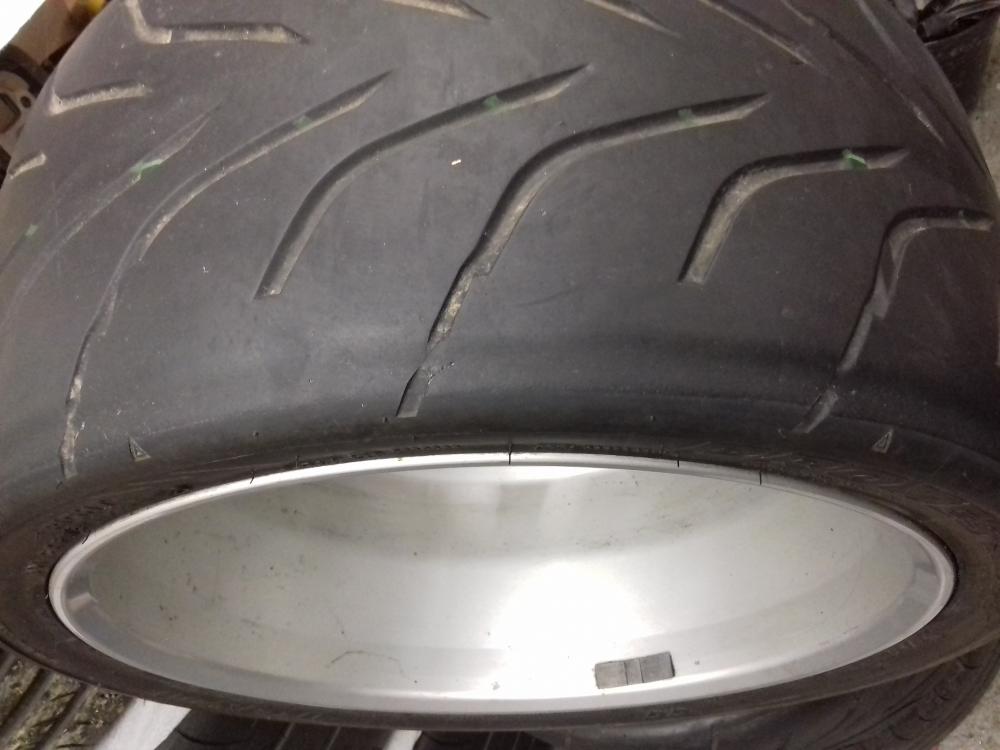

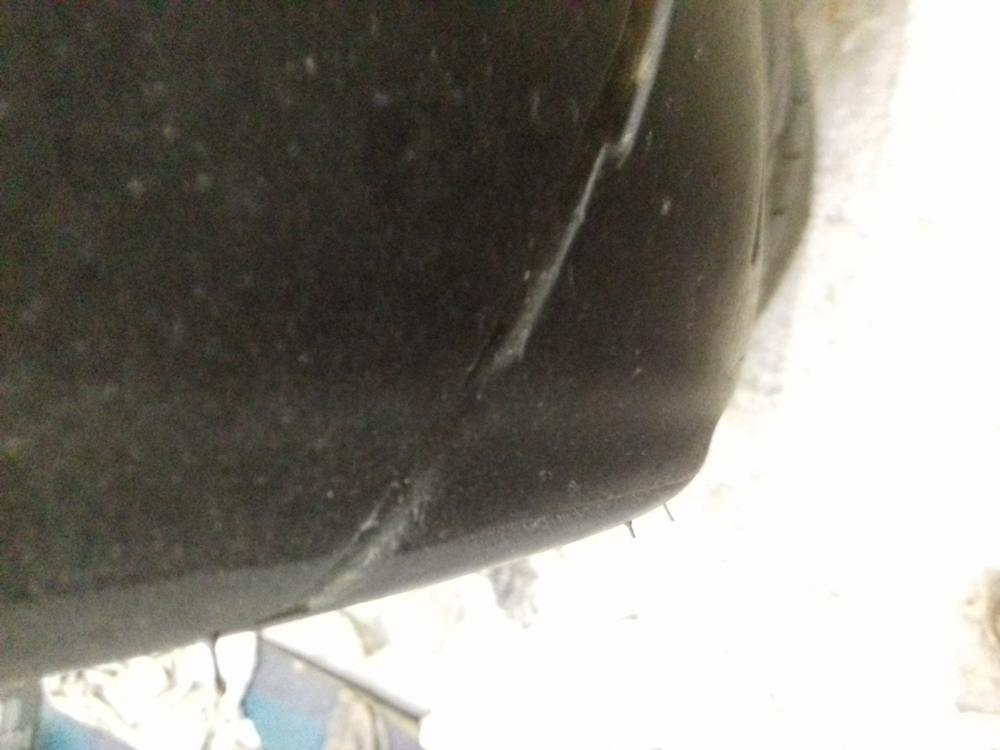

Lower ball joint?
Could this be caused by a worn wheel bearing? I have just recently replaced it on the LHS? I never noticed if the tire had a problem then.
Fatboy 18 said:
Could this be caused by a worn wheel bearing? I have just recently replaced it on the LHS? I never noticed if the tire had a problem then.I would think if the wheel bearing was that bad (to damage the tire that much) you would have noticed some excessive brake pad wear. My .02$
Tie rod ends are fairly easy to diag. Upper/lower ball joint can be a bit tricky.
Best way is to laterally move the wheel top and bottom. I used a pinch bar and a piece of thick nylon to protect the wheel. I checked mine once i seen the boots were bad..
Ok thanks, I will look into that.

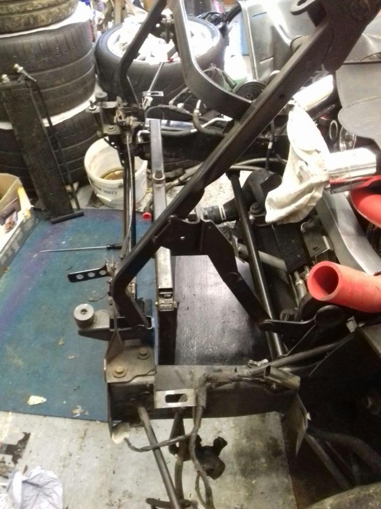

Meanwhile I have another little problem 🙁
IMG-20180401-WA0038.jpg -
That’s not a problem, that’s an opportunity! Testing for worn components is easier that way. Get the thing in the air and grab the tires top/bottom to see if the joints pop or flex. Pop the tie rods from the knuckles and check for excessive looseness or free play at both ends. A worn-“in” ball joint will move smoothly, but not floppy loose.
Fatboy 18 said:
IMG-20180401-WA0038-1.jpgUmmmmm…something is missing in this picture. :confused:
Yeah, no wonder I was having cooling problems, some low life nicked my radiator! 😀
Anyone know what would cause this? RHS Front is Fine, its just the LHS tire?
