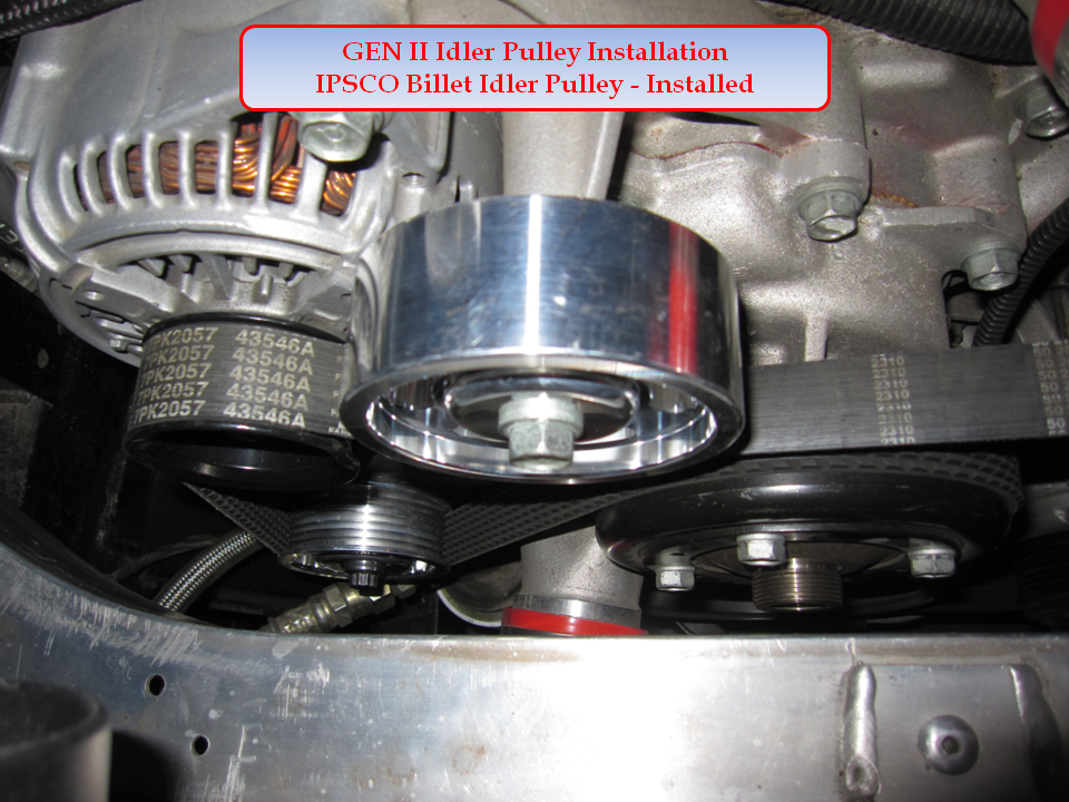

      Nope, wound up being my idler pulley blew its bearings and that caused it to lock up dragging my serpentine belt across it and then the serpentine belt snapped.

      52K give or take a hundred. Another guy around here blew his pulley at about 60K. Apparently that’s their time to go lol.
