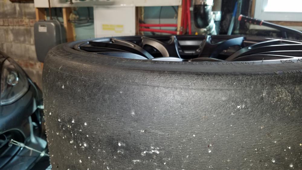

      Yes. So if I saw it I would change it out.
      Truth is I have driven them WAY beyond where that tire is at now. That tire has no more than 1 session left in it and will be showing steel next time around.
      That said now that you caught it I wouldn’t use it again.

      It may be corded like that for a reason. Look to see if the tire is scrapping against any body parts when the wheel is turned.

      Those tires are indeed toast and dangerous, definitely would not take out on another session.
      Yeah, I thought the same thing when I saw it first.
      Truth is, I was overdriving the car a bit (I could not help myself since it was too much fun) in the the Lightbulb at NJMP Lightning lap after lap and this front left tire took a beating.
      Very interesting how different tires come apart differently. But these R7s still lasted at least 3 times as long as stock Kumhos and I love that.

      Looks like the camber is spot(evenly worn) on for the tracks you’ve visited.

      The front is set up using the settings from Bondurant racing school (from the time they had ACRs there). I also have the Snake Oyl camber plate kit installed, so the camber is always -2.5.
      I can’t see the actual cord, but I think it’s about to come out?
