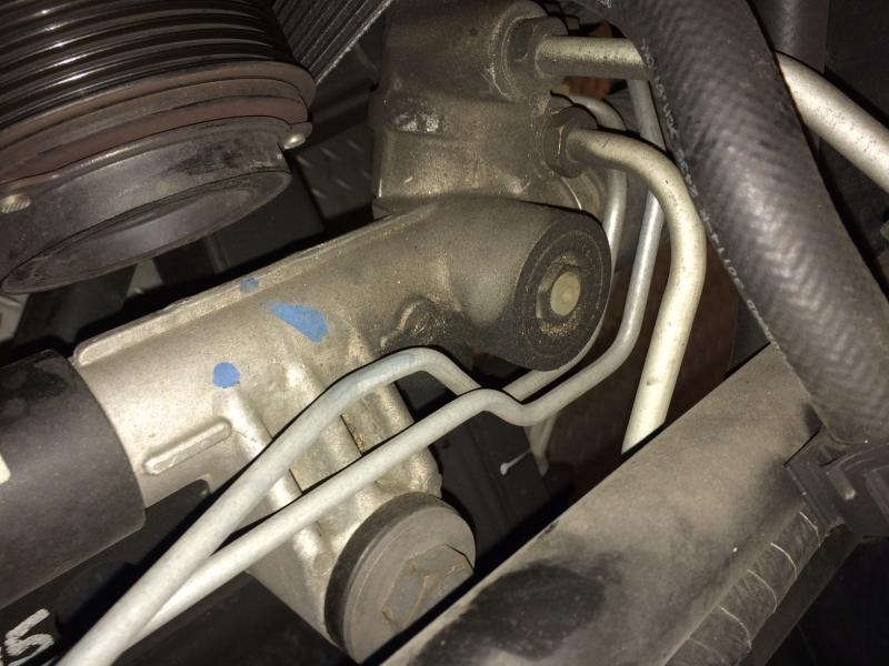

      I managed to fixe the play in my steering wheel : I turned the 17mm adjustment screw 1/8 turn clockwise.
      My steering box has a little play (1/32). On many cars it is possible to tighten the steering gear box with an adjustment screw.
      Is it possible to do this on the Viper’s steering gear box ?
