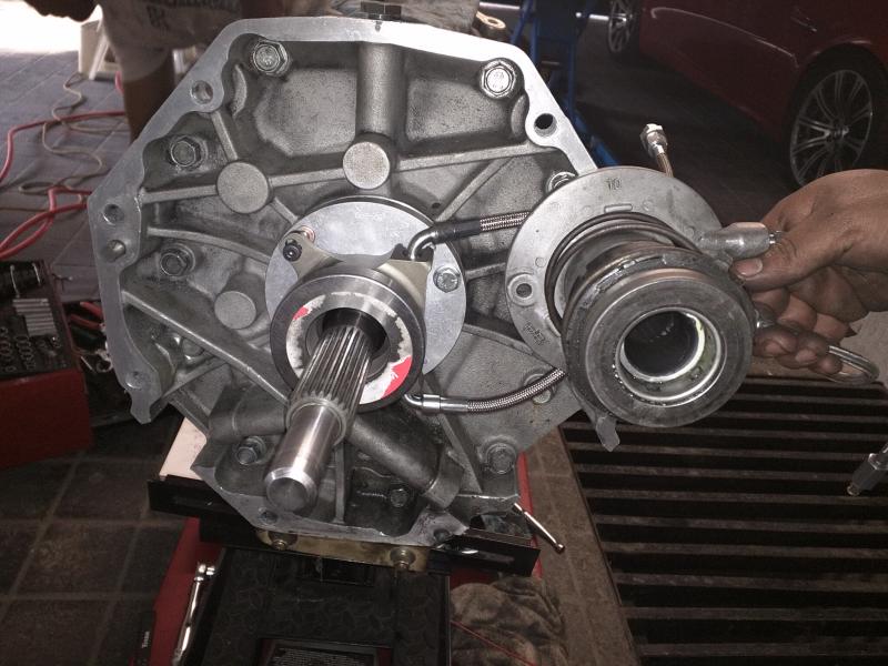

      Just curious, how did you get around the quick disconnect? By slave is leaking again I would love to switch over to this one.

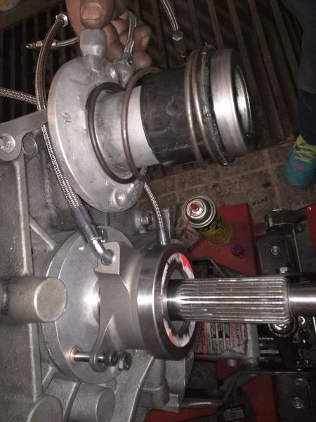

      Cut quick connect end and install AN4 fitting instead, and then a coupler.
      Any adjustments needed during installation?

      So I had difficult time searching a replacement for stock clutch slave cylinder, made some measurements and ordered TILTON 6000 series for my Tranzilla/T56 transmission.
      THIS THING IS GREAT!!! no plastic, pedal run is shorter = quicker shifts, firm shifts, upgraded bleed screw.
      So if someone is looking to replace stock cylinder, you have now a choice.
