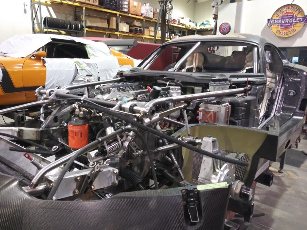

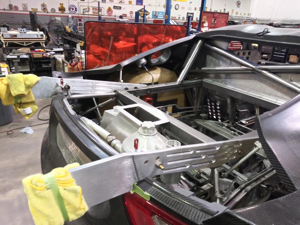

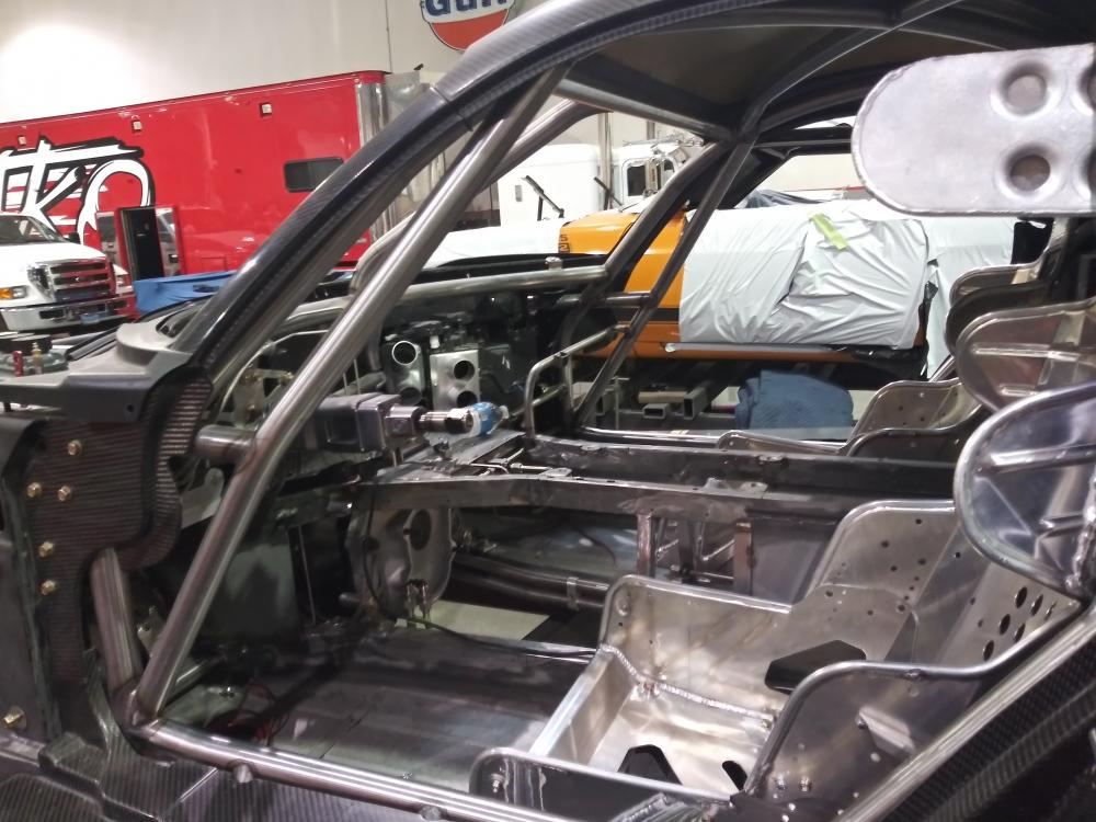

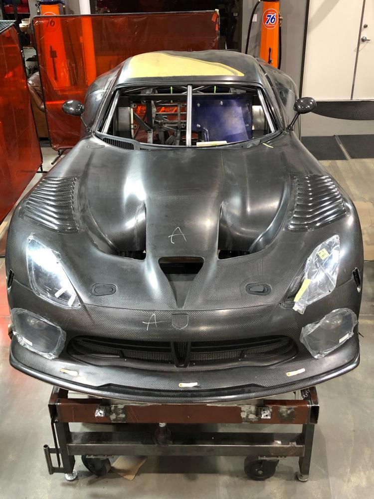

      Viper GT3R Car#1 update pics . Not going to look like there is much difference from last up date pics. Car now has driver adjustable front sway bar, nose box is 90% complete, AC system plumbing, power steer plumbing with quick disconnect just about done. Intermediate rear wing mounts and some other plumbing finished. What the pics dont show is front and rear uprights machining, axle machining, brake hats being machined. bearing carriers being machined and host of other odds and ends being machined or fabricated.
