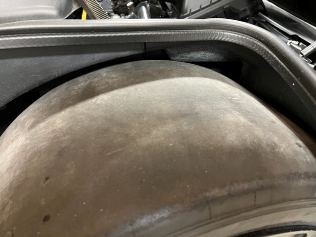

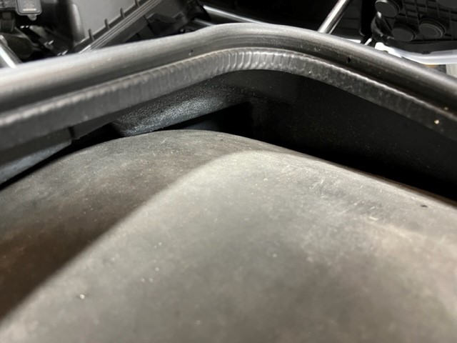

13COBRA said:

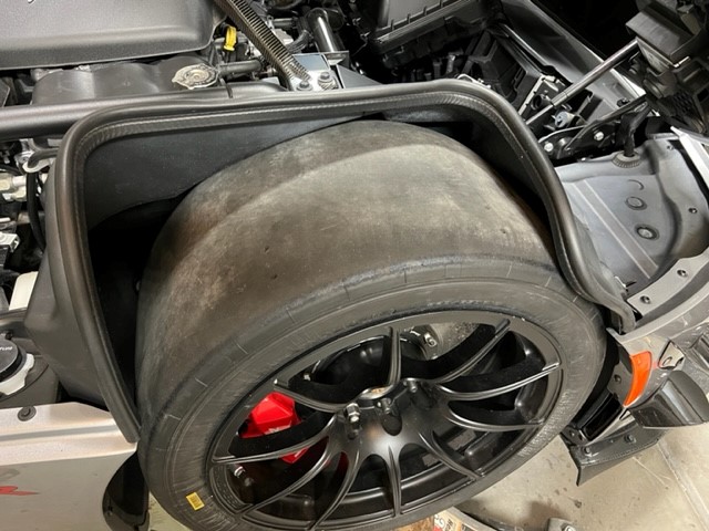

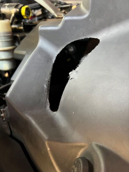

I'd have a really hard time raising the car to run taller tires. Better off keeping it lower.I agree. Cable and I discussed buying a new set of fender liners and cutting holes for clearance, keeping an unmolested set for replacement later. I could easily build CF “covers” for the holes that provide the necessary clearance while keeping debris out. It is really hard to find a good, wide slick, even in 18″ sizes, that is as short as the factory Kumho with its “25” side wall. The Finspeed 12″-wide wheel seems to have the optimum back-spacing – I do not have room to move the tire in or out to improve the situation. In the photos above, the wheel/tire is jacked up to a point that puts the splitter 1″ off the ground (anticipated full compression). I am looking at shock bump stop options that will control that height without an abrupt spring rate change when they bottom.

jrubin80 said:

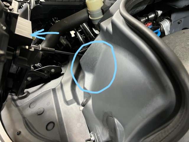

Does anyone have a photo of a slightly smaller mounted? Is there still a 300/650/18.Don’t have a photo, but the Michelin 30/65 is .5″ narrower and .5″ shorter and did not rub on my car. It looks like the offending area of the tub causing the rub is an indention for headlight assembly clearance. There is, however, an over 1″ dead space between the tub and the assembly – plenty of space to prevent a rub.

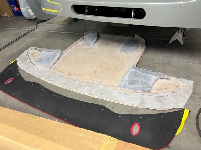

EX: Corner entry car is good and takes a set, mid corner car is ok, beginning of corner exit part throttle car has a slight push that gets progressively worse adding throttle. Possible fix would be to pack the bump stop or maybe run a slightly taller bump stop. All tuning and messing around of course always hinges off everything else being in the ballpark.Concur with your assessment. This crude construction shot shows the mold (under construction) for a front Kevlar and carbon fiber undertray that will accommodate one of your Viper extreme splitter extensions. The extension will attach exactly as it does on the Viper – flush with the undertray. It has four diffuser ramps, the back two of which will empty outside of frame rail barge boards behind the front tires. That will direct airflow down 14″ wide diffuser tunnels that run between the frame rails and the outer side skirts. There will be strakes on the bottom of the undertray to help direct airflow toward the tunnels as well – much like NASCAR currently uses to direct airflow outside the rockers.
NASCAR strakes. The C8 Z06 has them as well.

Nice work Pappy! I’ll have some Yoko 300 fronts for you soon, I have one set of the soft compounds and they don’t make a 320.
Where do you guys buy your Yokohama track tires? I have been looking all over but can’t find new ones for sale.

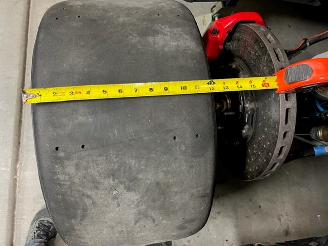

FWIW. For those experimenting with track tire sizes, here is a Yokohama data point. I went to the new Podium Club @ Attesa track (Casa Grande, AZ) this weekend and tried Yokohama A60s – the same tire Cable has been running on his 9L during Global Time Attack. 320/650X18 front, 330/710/18 rear. The 320s on front run wide and were the same width as the 335 A7s I had been running, and they were 1″ taller than the factory Kumhos. I was running 2* negative camber and 7* caster, with the ride heights at 4″f and 5.5″ rear. I also was light on front shock compression, and heavy on rebound. Got my eyes watered! Under hard braking the fronts would rub hard in the top inside of the wheel tub at the front. – so hard that it would cause a little side-to-side shimmy. Worse than that, with the nose down (heavy braking with lots of rebound stiffness) I could not turn without the inside edge of the tire hitting a protrusion in the front of the wheel tub (see photos). Cable got by with this because he had already worn big holes in the tubs – LOL. So, I couldn’t brake and I couldn’t turn, but the IATs were low and the car hauled like a banshee on the straights. I ran a few laps with light braking early and accelerated into the apexes to pick the nose up and minimize the binding, but that wasn’t the quickest way around the track so I packed up. You could run these tires (they have great grip) with a little higher (maybe an inch) ride height, more compression stiffness, perhaps a different bump stop configuration on the shock, and holes in the wheel tubs – probably not worth it.
