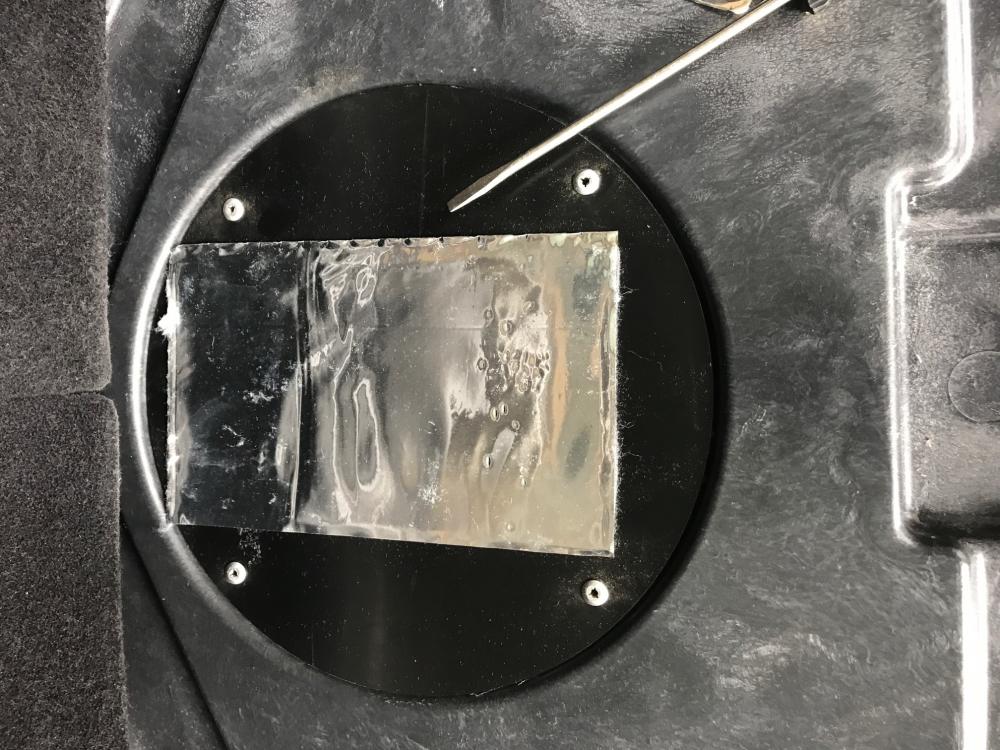

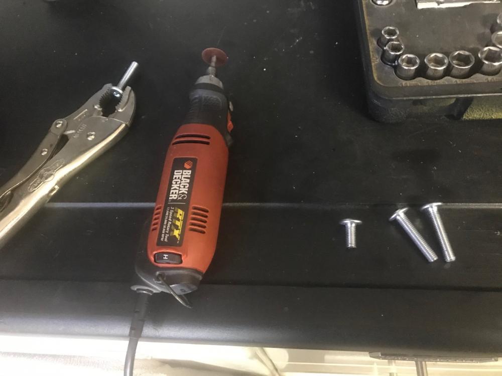

I used a 9/16 drill bit and carefully drilled out the center of each bit until loose. Then using a small flat head screwdriver, lift and remove each rivet which holds the plate in place. I used a shop vac to vacuum up the aluminum debris before removing the plate and then continued to get the rest of the aluminum shards vacuumed out around the sending unit on the top of the fuel tank. There is a styrofoam cover on top of the sending unit which comes off easily. Afterwards, I took the extra step of cleaning the area thoroughly to avoid getting any dirt in the tank once the factory sending until was removed:

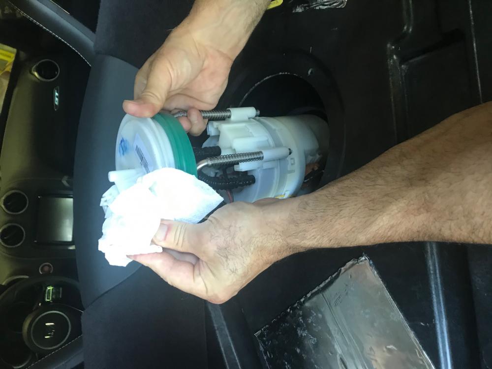

On to day 2 and finish this project. I should have known this would take more than an hour so why I started yesterday is beyond me. Before we get going, let me suggest that anyone attempting to do this project needs to have some basic knowledge of mechanical and electrical components and I highly recommend having a friend come help for a second set of hands. The locking ring is VERY tight and I bet there is a specific tool (which I didn’t have) to get it loose enough to unscrew by hand. Without the tool, I was forced to improvise, adapt, and overcome… with a hammer and a punch with a flat blunt edge. Yes, I took a hammer to my Viper and can hear the groans as I type this. :slap: Carefully, I used the hammer/punch and went around the locking ring at every tab and it finally began to rotate. Once it was loose enough to be removed by hand I disconnected the electric coupling and fuel line, drained a the fuel out of the line, wiped it up and then removed the fuel sending and gauge assembly:

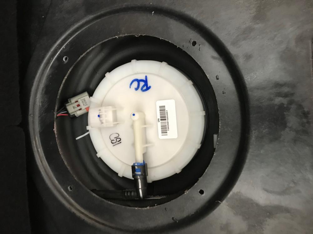

Once out of the car, I covered the exposed fuel tank/fuel with a plastic bag to ensure no debris blew in. Next, you have to drain the fuel out of the unit. I took this opportunity to cut my new hardware to use instead of the rivets:

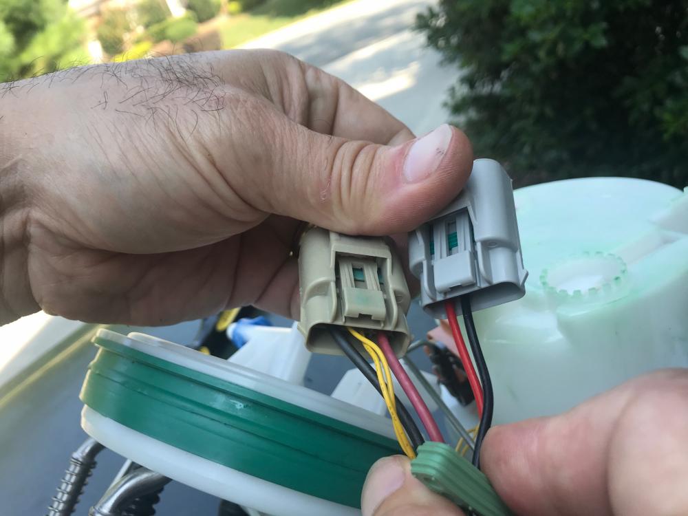

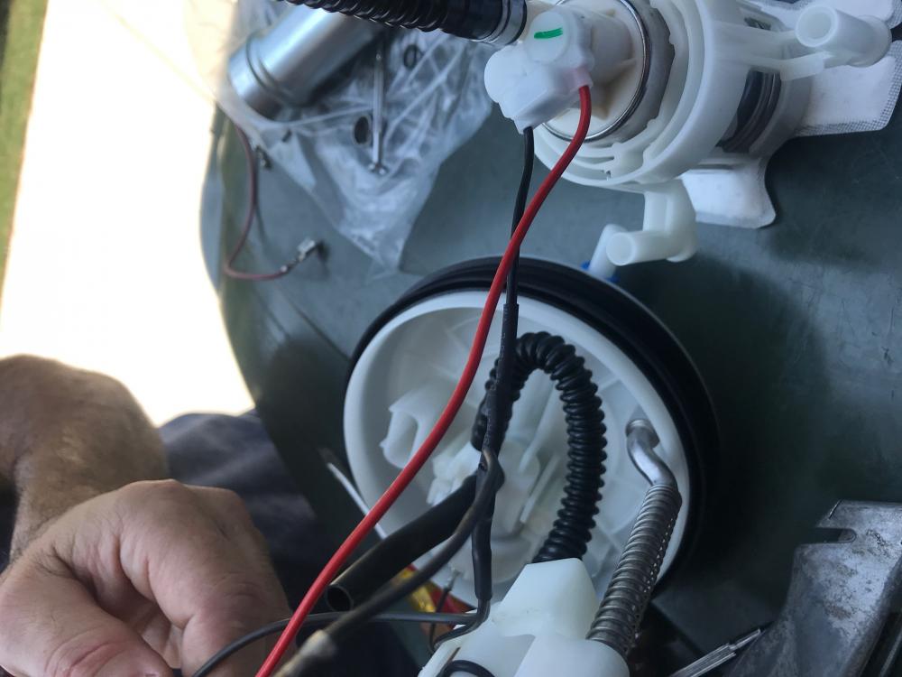

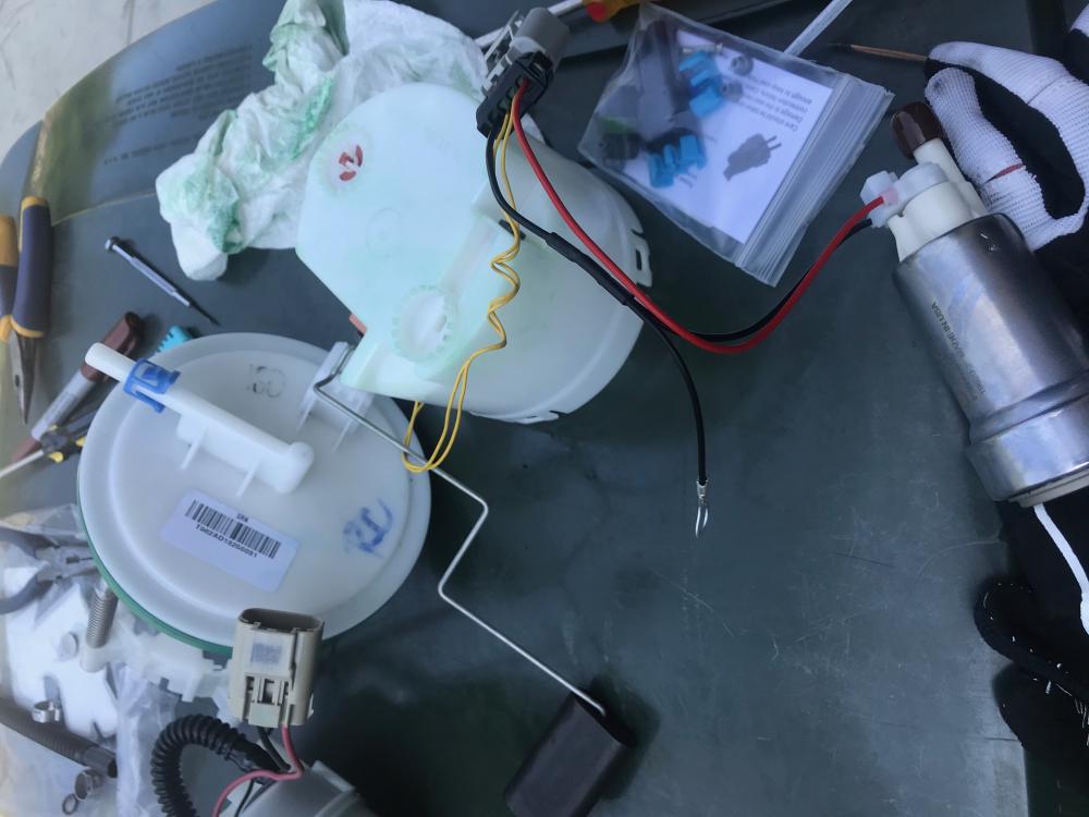

Once all the fuel is out, its time to take stock of what you’re dealing with from an electrical standpoint and I can’t stress this enough. The new sending unit has slightly different wiring than the stock unit and you need to pay close attention to where each wire is pinned in the coupling (my friends hands coming in handy). You can take a mini flat head screwdriver and release the pinned wires out of the coupling and put them into the new coupling in the correct order. Make sure you mark which yellow wire is closest to the black wire otherwise your fuel gauge will no longer work properly:

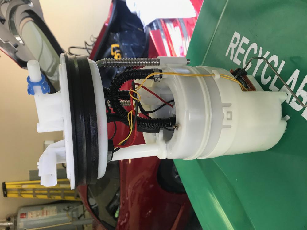

Now time to take the unit apart. This is where a second set of hands comes in and almost a must. There are three sections to the unit and you’ll need to start by removing the top section with 3 connector tabs on the inside which will be a little tough to get. I used a long small flat head screwdriver to move the plastic latch around the tabs and then gently wiggled the top section off. All wires still connected, but now you can also remove the bottom reservoir from the center filter section:
Its a good idea to clean all the parts at this point and I used some brake cleaner to get some debris out of the bottom reservoir and then cleaned a couple other areas as well. Take note of the resistor on the top which the wire hanging down is going to have to be soldered onto the new sending unit wires later.

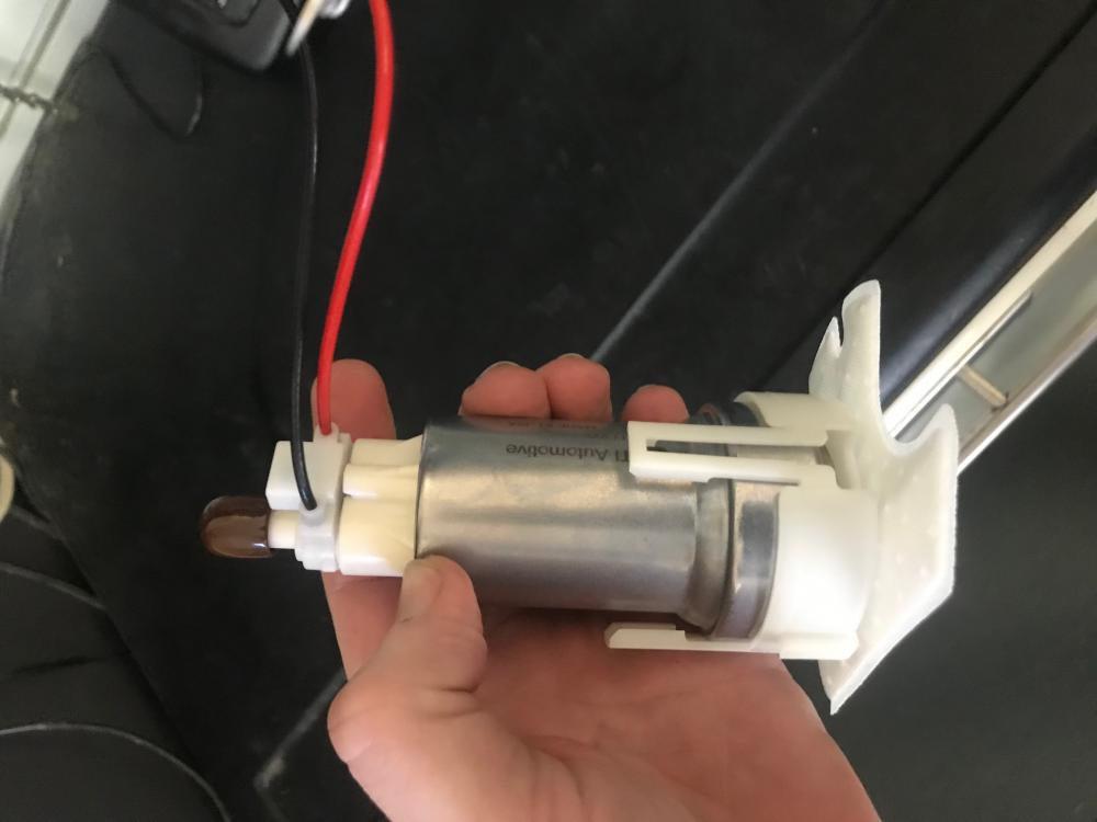

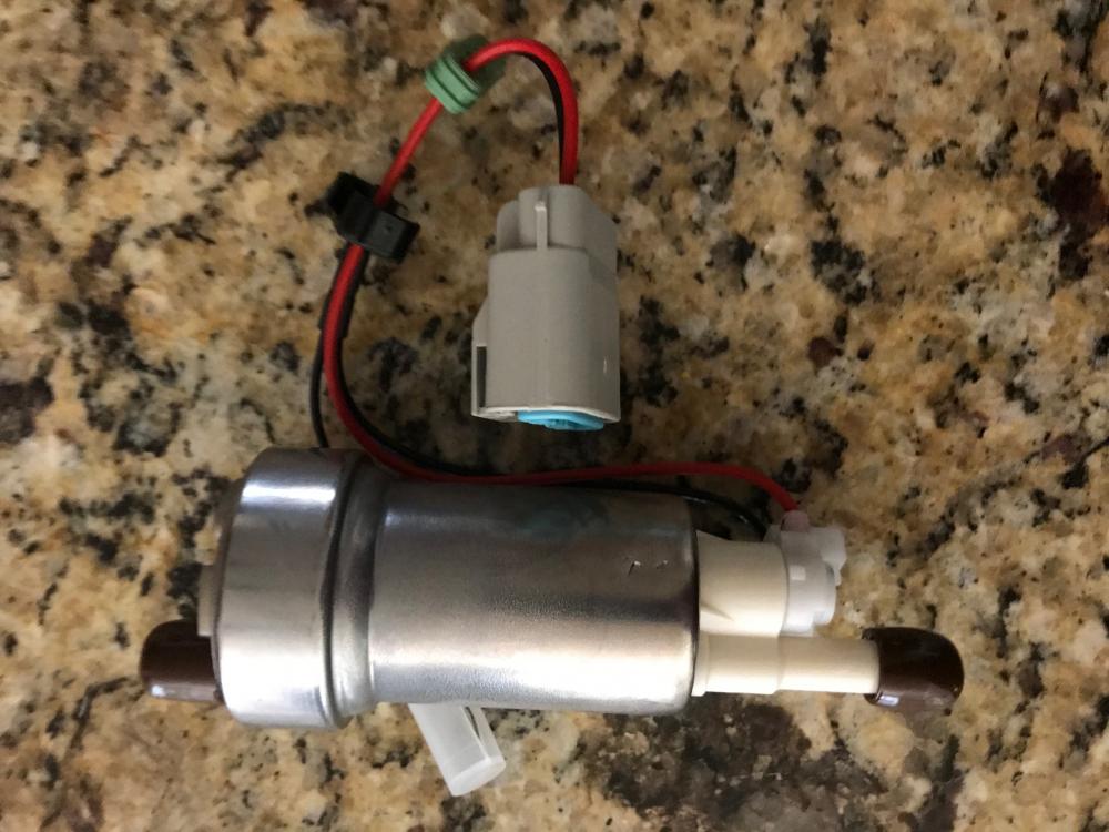

Now its time to remove the old sending unit and install the new unit:
Attachment not available
Attachment not availableTake the fuel filter off the old unit by using a flat head screwdriver and prying off the filter. This will then allow the locking assembly around the fuel sending unit to come off and then replace with the new unit and install the new fuel filter by pressing onto the inlet of the sending unit:

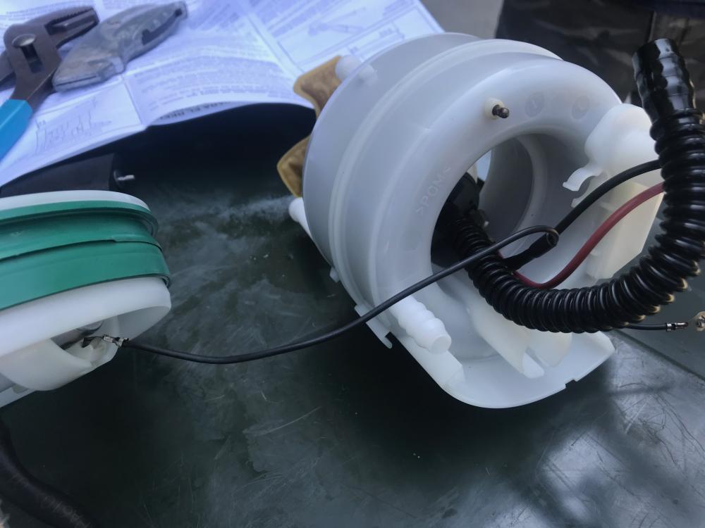

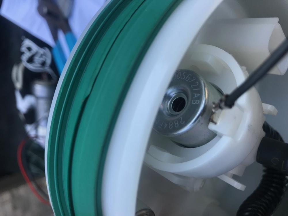

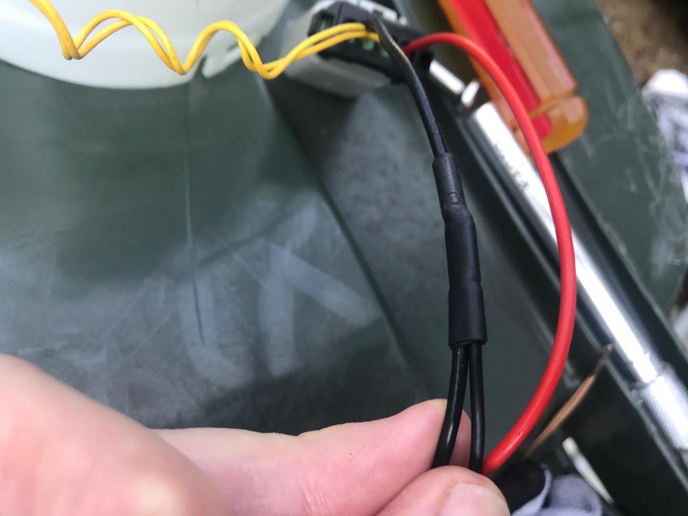

This is where you need to look at how the old sending unit is wired into the assembly:

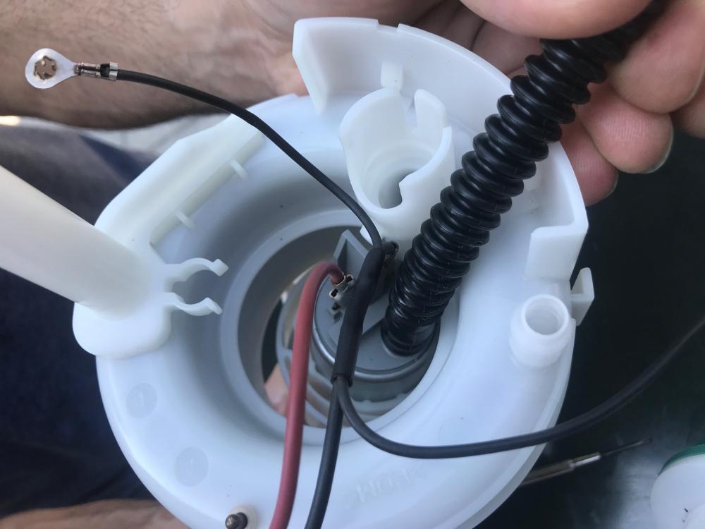

After talking with Todd at Prefix this AM (he was very gracious to make himself available on a Sunday) I cut the black wire on the new unit and striped/soldered to the existing black ground wire and then heat shrinked the exposed wire to ensure it was completely secure. Then I had to cut the wire going to the resistor so I could begin reassembling the sending unit in the bottom of the unit. This is also the best time to change the green rubber seal and replace with the new black rubber seal.

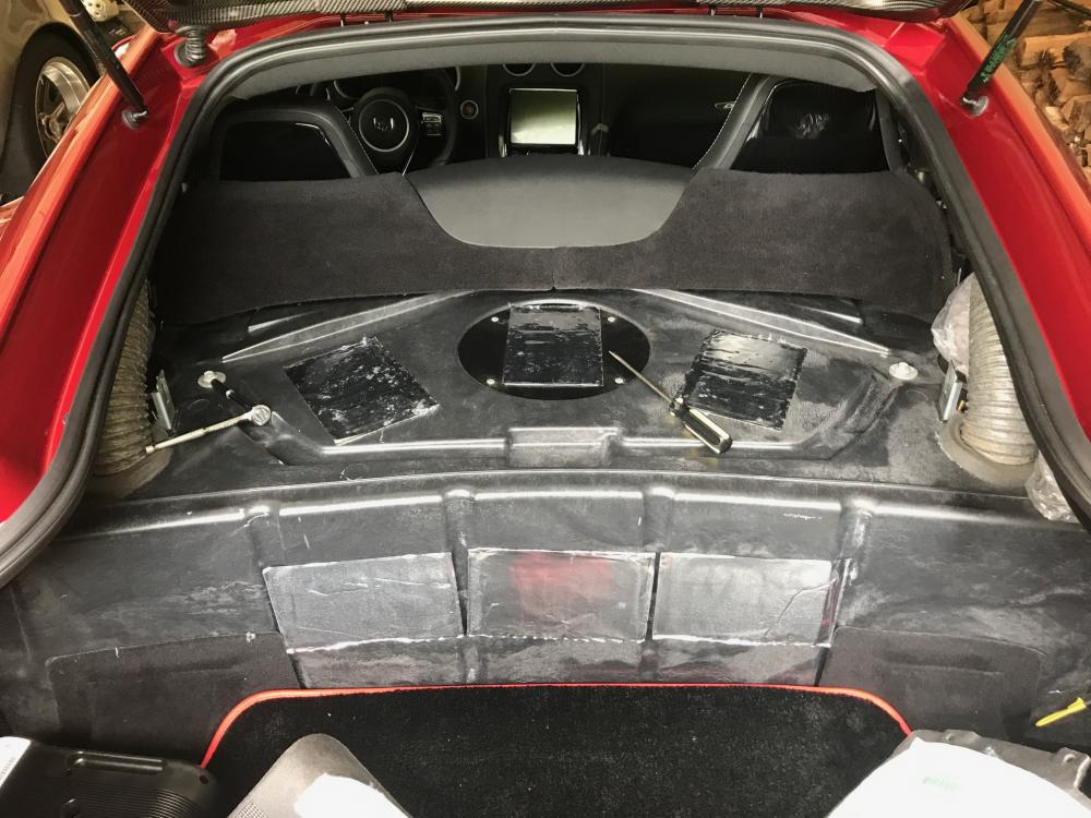

Scot gave me a couple of quick tips and I decided to tackle this one myself. To access the fuel sending unit, you first have to remove the side panels just behind the seats and also the carpeted panels in the cargo area. Once removed, there are two 10mm nuts on either side under the rear brake duct hoses you will need to loosen so you can gently lift the carpeted panel directly behind the seats which will allow you to release pressure on the carpet covering the access panel to the sending unit. You can now gently remove the carpet on the shelf by lifting over the tabs on driver and passenger side, then slide out towards the back of the car, and then lay aside. This gives you direct access to the panel:
There are 4 aluminum rivets that will have to be drilled out:
