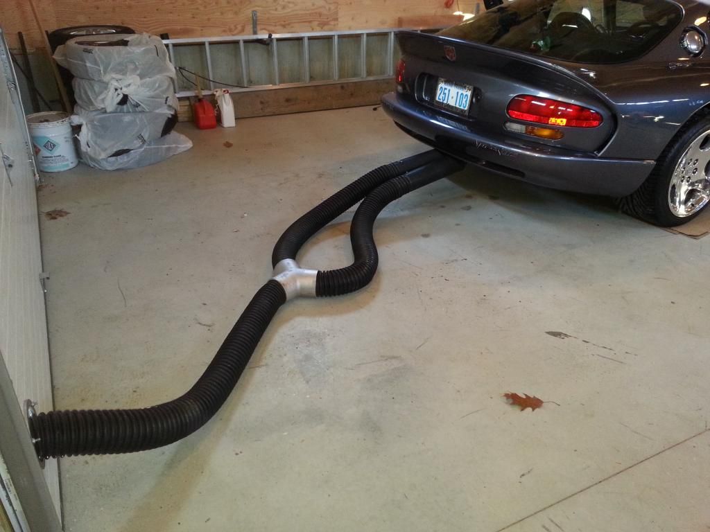

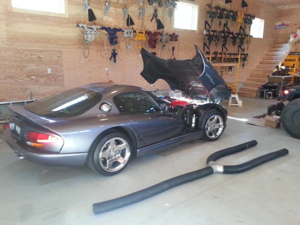

      – For a Viper, we will need to run 4” hose, bells, “Y” fittings and door port(s). Using a 3” system will not work and will literally blow the bells right off your pipes. It is also important to know that the proper fit of the bells over your exhaust tips requires that fresh air must move through the small gap between your exhaust tips and the bells. In other words the fit is not tight, it is not loose, it is a proper fit that comes when one matches a well designed 4” flow bell.
      – Lead in to the “Y” connector is important and should be no less than four (4) feet. Overall length of the complete system should not exceed 12 feet. Remember that the hose can go outside through the port so the extra length in some bays can just go “out the port.”
      – Keep the exhaust port “door” about 6″ off the floor. You will see I re-engineered the port so that it would work with a thick, insulated garage door and be, itself, insulated and locked when not in use. Simple modification.
      – There is no maintenance on any parts of this system. Expect it to last a minimum of 15 years as 15 years is daily use service. We are warming the rig up what, once a week here?
      – This whole system is engineered to “fit” together. There is no adhesives, tapes, wires, wraps, etc. The hose literally ether goes over with a friction fit or screws into the other operational parts.
      – The INTERNAL DIAMETER is 4″ but the external diameter is a full 5″ and the hole you drill through the wall/door is 5 3/8.”

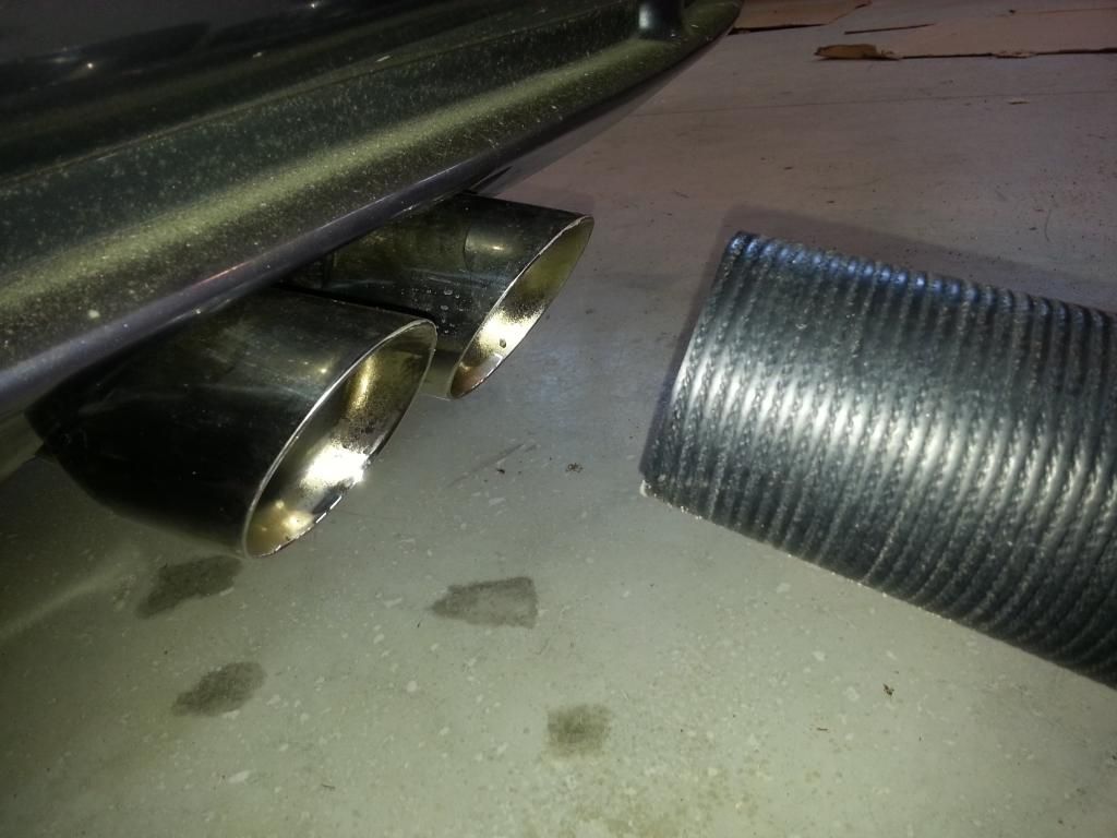

      – My system has two (2) independent hoses that go over each of the dual exhausts. Once again.YES, one can get inserts for flush exhaust side pipes and just about anything else you can think of.
      – The Pieces I used:

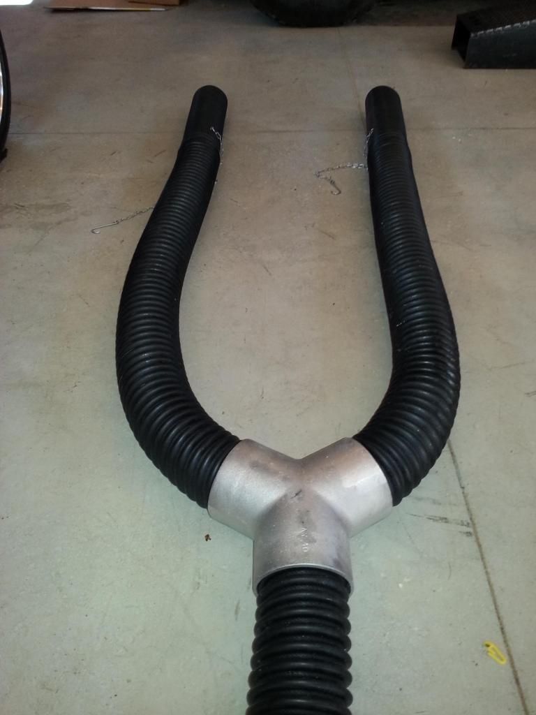

      The Hose = 11” FLT400
      The “Y” Fitting = AY40
      The two (2) Exhaust tip Bells = F400 (2x)
      The Door/Wall Port = ADF40
      You can figure on spending around $300-$400 to make this all come together.
      Here we see the four (4) foot long lead ins to the “Y” connector. The gas to expand and settle out before the combination into the final last leg.
      This is high quality material folks. Parts of the system will last forever.
