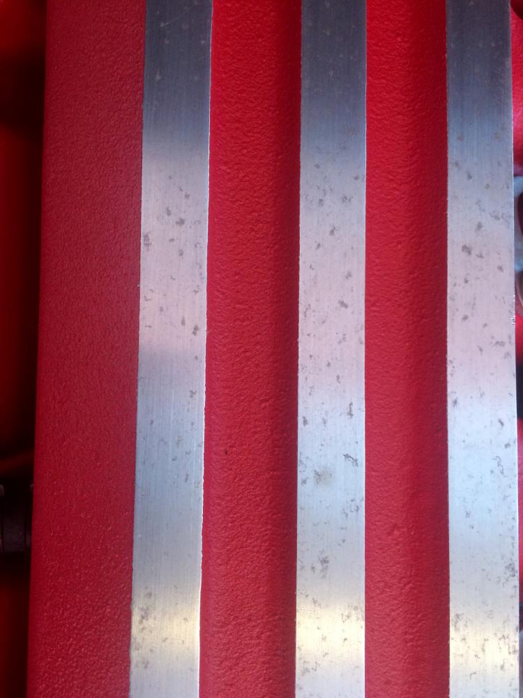

      The intake manifold is aluminum and what you are seeing there is minor pitting corrosion. I’ve cleaned/polished my IM ribs a couple times by wetsanding with a home-made sanding block. One rib at a time, stroking along the length with light pressure. First time: 1000, 1500, 2000. Next time only need 1500/2000 or just 2000. It can get messy. Make sure to tuck an absorbent towel between the IM & valve covers and tape off a towel between the snaking intake runners to catch excess water.

      The Mag/Aluminum liquid/paste polish will shine them up but i dont think it’d be enough to get past the pitting defects. I personally wouldnt use it because there is also some pretty aggressive chemicals in there that i wouldnt want effecting the paints adhersion to the metal. Ive seen a lot of viper motors where the red podwercoat is bubbling & or missing in areas and the reality is that the thing is 20years old and goes through alot of heat cycles so you can only expect so much but i definitely would not want to do anything to expedite the aging/deterioration. If you do use it be quick and follow up with a towel and cleaner to remove all the residue.

      DirtyD said:

      The Mag/Aluminum liquid/paste polish will shine them up but i dont think it'd be enough to get past the pitting defects. I personally wouldnt use it because there is also some pretty aggressive chemicals in there that i wouldnt want effecting the paints adhersion to the metal. Ive seen a lot of viper motors where the red podwercoat is bubbling & or missing in areas and the reality is that the thing is 20years old and goes through alot of heat cycles so you can only expect so much but i definitely would not want to do anything to expedite the aging/deterioration. If you do use it be quick and follow up with a towel and cleaner to remove all the residue.

      Lots of good info here , and it is very common , unfortunately. Trying to remember what we did to try and correct it , but never tried what Dirty D suggested and that sounds quite promising?!

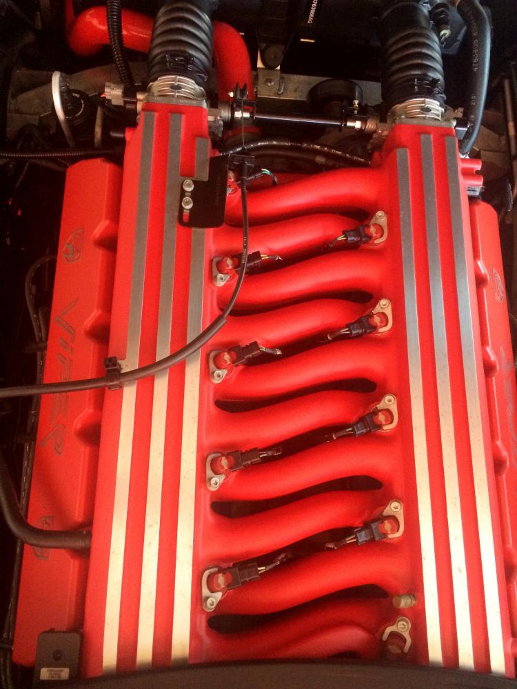

      Tried tar remover, goof off and others to no avail. What are these spots and what can I use to remove them?
