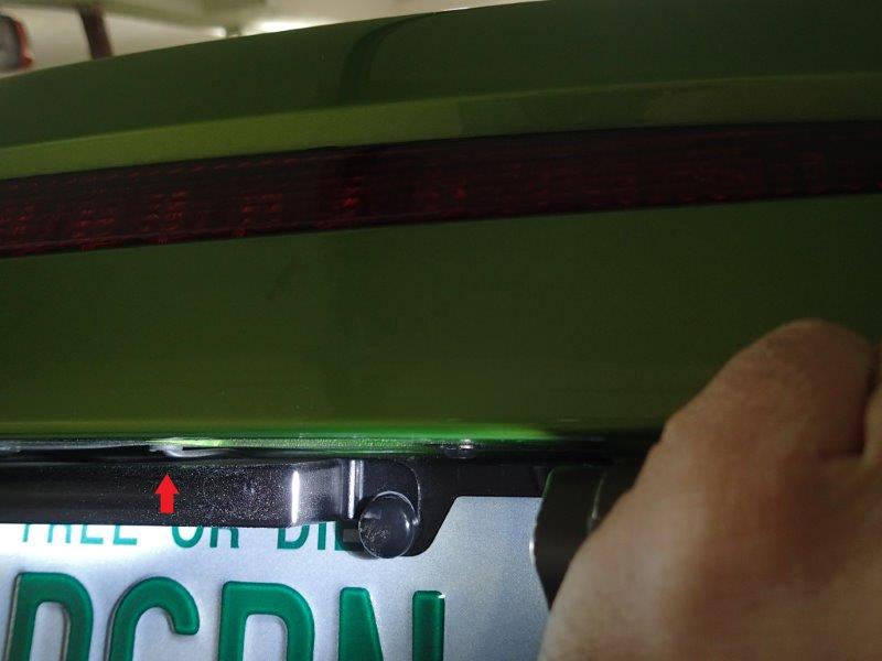

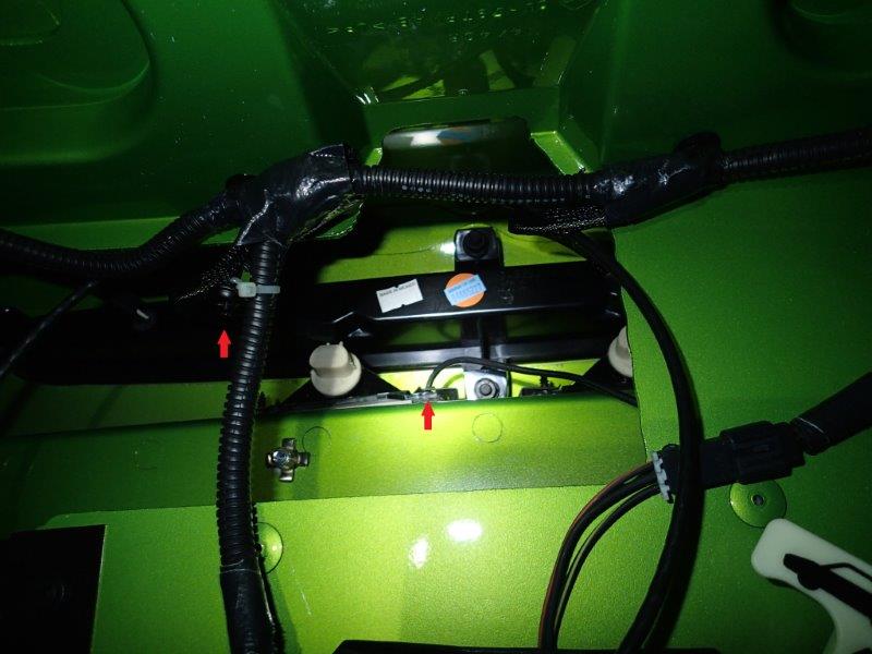

      I didn’t want to drill any holes in the car so I came up with this solution. I removed one of the license plate lamp screws and I ran the laser shifter wire through the screw hole (Note: I also used a grommet). This way I can easily return the car to stock if I want to remove the laser shifters. I zip tied the screw I removed to the harness so I wouldn’t lose it.
      The only downside to this approach is that you will need a telephone cord crimp tool kit to replace the modular connector. These kits are pretty inexpensive.
