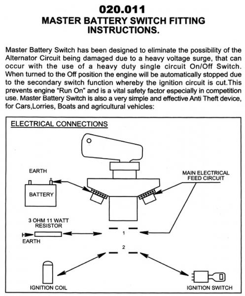

      The battery is disconnected for a couple of days, because I’m installing a Kill switch in the car.
      I don’t work that fast…:witless:
      As I recall, there have been reports of PCM failures on Gen IV’s with sudden power kill. Obviously, this was overcome on the ACR X Vipers.
      Heysie, how do you plan to wire in the kill switch?

      I’ve cut the main feed just before the fuse box.
      And only used connection #1 with the resistor as in the picture.
      Don’t use connection #2, because the ignition coil is fused after the kill switch. So that will be shut off automatically.
      Did already pulled that fuse with running motor and the engine did quit.
